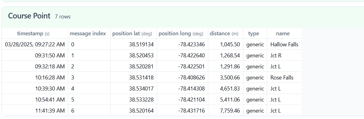

I use routeconverter to create my track. Garmin devices allow course points which provide instructions along a route. I have been using either garmin connect or another tool to create these course points from routeconverters uploaded track files. Garmin devices uses these points to identify up ahead points with an option for instructions. They are different than track and waypoints and I believe they must be on the track. Attached is an example of these points extracted using a tool that extracts them from a FIT file created from garmin connect. If coursepointmesg is equivalent can you provide instructions for how to define or create these points along the track. I tried to drop a FIT file with these course points in the attached files but I get an error message saying the type of attached file is not owed. The photo shows the course points that was extracted in the FIT file. I would be happy to send you a FIT file.

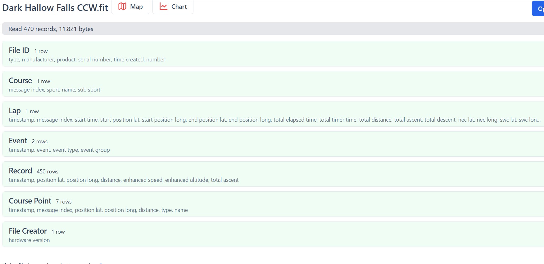

Ok, the file you've sent me contains a lot of Records (named record 34) and a few Course Points (like Hallow Falls 66). To me this looks like a track. And when you filter only the Course Points, it's a route? Sorry I'm confused how Garmin handles this.

(28.04.2025, 16:09)routeconverter Wrote: Ok, the file you've sent me contains a lot of Records (named record 34) and a few Course Points (like Hallow Falls 66). To me this looks like a track. And when you filter only the Course Points, it's a route? Sorry I'm confused how Garmin handles this.
Thank so much for continuing to look at this. Garmin uses these additional points to prompt the user with turning instructions or to identify points of interest along a track. If you open the file I sent you with https://www.fitfileviewer.com/ and scroll down to the track records and course points you will see that they are differently treated. I can also add these course points with 'plotaroute' instead of with garmin. Course points must include the distance from the begining of the track and includes options for naming and instructions such as 'turn left' or 'here is th sign'. Let me know how else I can help.
Here is a screen shot of the file using fitfileviewer. You can see that the track records and the course points are treated differently. Screenshot 2025-04-28 084423.jpg
