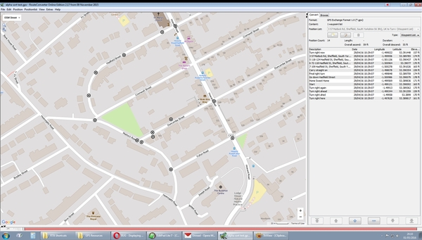

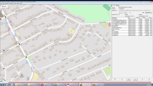

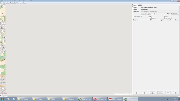

This is the sequence I went through
Only this time it didn't go wrong! although the map in the 3rd picture is slightly out of position.
When it did go wrong the map was either missing or partially displayed in image 3.
Do you cache the maps or is it downloaded each time it's displayed? If the latter maybe there's a broadband speed issue (I'm in the UK after all)?

It's happened again - I followed the sequence in post #7 as soon as I started the program and this was the result:
Also, sometimes the point markers don't always disappear after they are deleted from the position list.
Maybe a "Refresh Map" key is required - F5?
