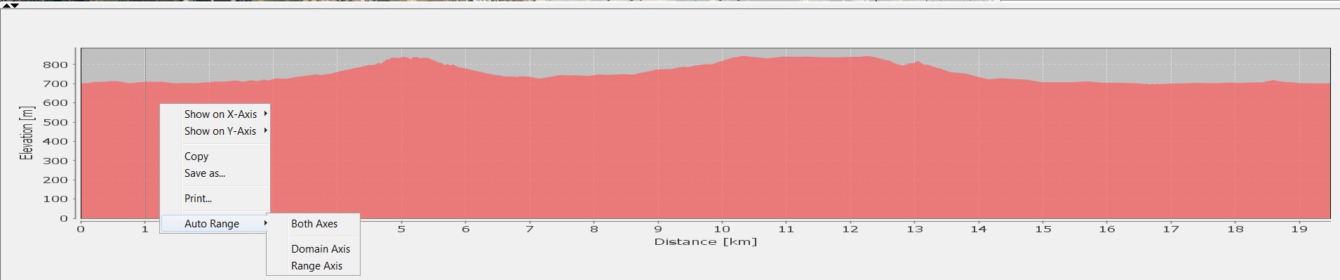

Autorange Y-Axis don't work as expected (nor "Both Axes" or with "Range Axe").

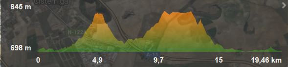

I have a gpx track with points with Elevation between 698m to 845m.
When I click Autorange "Both Axes" or "Range Axe" I expect the chart between (more or less) this values but I always get the chart starting in 0m so it lose "the perspective".
RouteConverter 2.18.5
Example of expected Chart:

(08.09.2016, 13:14)V.V.V. Wrote: Autorange Y-Axis don't work as expected (nor "Both Axes" or with "Range Axe").
Unfortunately, your zoom-in-as-much-as-possible is not the default behaviour that the JFreeChart library offers with the Autorange actions. I could have removed it but since it's useful to some people I've kept it. Reimplementing is not an option, have a look at the code and you know, what I mean.
(08.09.2016, 13:14)V.V.V. Wrote: When I click Autorange "Both Axes" or "Range Axe" I expect the chart between (more or less) this values but I always get the chart starting in 0m so it lose "the perspective".
Autorange currently means: range from 0 to the largest value.

(18.09.2016, 20:17)V.V.V. Wrote: Others with setAutoRangeIncludesZero(false) or, in the same link, finally make the "roundabout" the setting the limits before call the graphic function.
I've tried this with the latest prerelease which I've just uploaded. Please test and report.
It works fine. It's just I needed.[Image: biggrin.gif]
