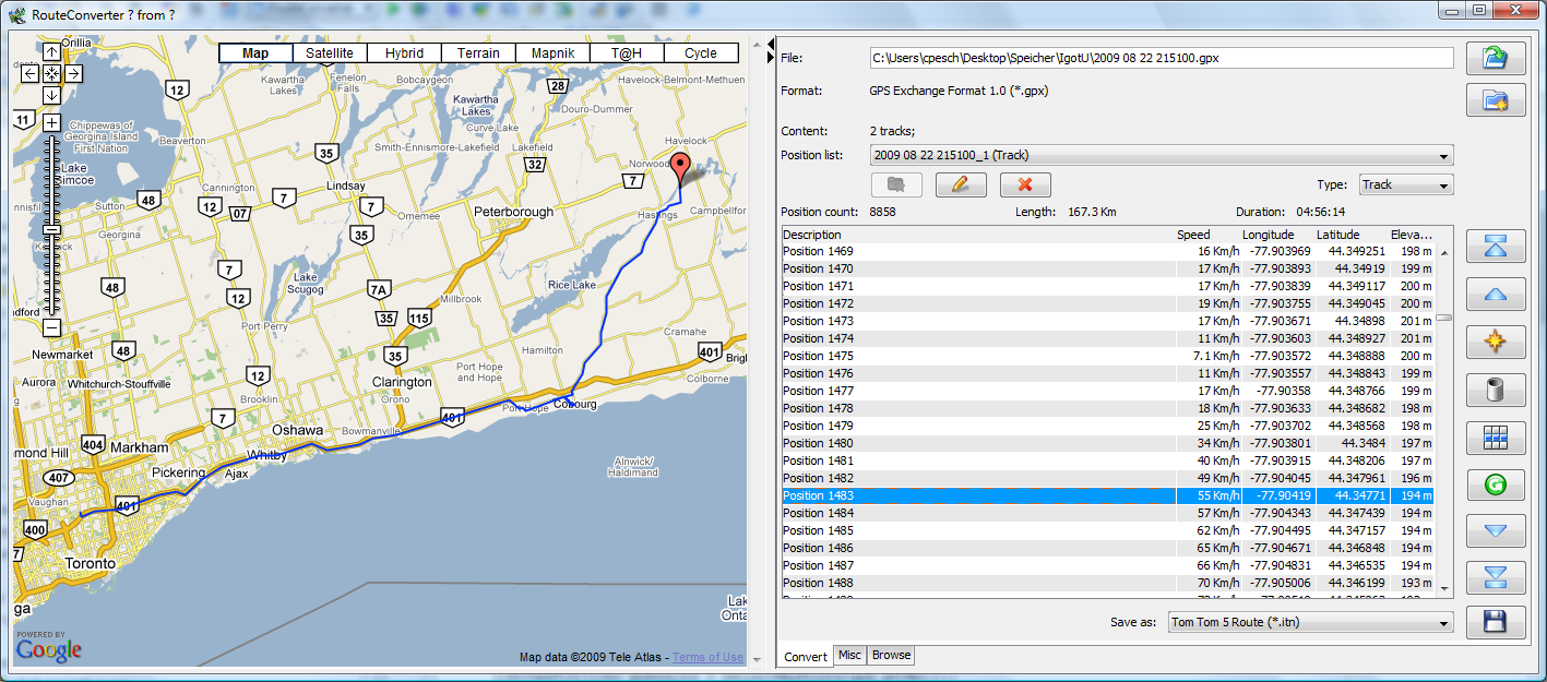

22.08.2009, 23:40
(This post was last modified: 22.08.2009, 23:44 by RsH.)
(02.07.2009, 13:51)routeconverter Wrote: (02.07.2009, 07:04)RsH Wrote: RouteConverter calculates the speed for me.
Hi Bob,
I should have read further... that calculation is based on Km/h, so everything should be fine. In GPX 1.0 there is a element for track points that uses m/s.
Now I am using software where the company exports to GPX and exports the speed incorrectly as km/h so when I load it into RouteConverter the speeds are showing as impossible values, due to the difference between m/s and km/h.... Treat km/h as if it is m/s and the speed shown is well in excess of the speed limit <grin>. The OTHER GPS does NOT calculate speed, so RouteConverter does it and I can rely on its values... So is there a switch where I can say, treat this GPX as if it was right and uses m/s and threat this other GPX as if it is wrong and uses km/h?
