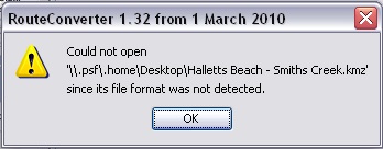

The attached .kmz file produces a 'format not detected' error dialogue in RouteConverter 1.32 running under Windows XP, as may be seen in the attached jpeg pic.

Could someone advise how I might be able to resolve what the issue may be.
The .kmz files opens OK in Google Earth; thus it appears to be a work
The file itself was generated by a Navionics app running on an iPhone3G.

(05.04.2010, 23:25)d101au Wrote: The attached .kmz file produces a 'format not detected' error dialogue in RouteConverter 1.32 running under Windows XP, as may be seen in the attached jpeg pic.
Hi d101au,
thank you for reporting a 2,5 year old bug which is affecting very rarely used constructs of KML-files. Please try the
current prerelease which works fine for me.

(06.04.2010, 13:27)routeconverter Wrote: (05.04.2010, 23:25)d101au Wrote: The attached .kmz file produces a 'format not detected' error dialogue in RouteConverter 1.32 running under Windows XP, as may be seen in the attached jpeg pic.
Hi d101au,
thank you for reporting a 2,5 year old bug which is affecting very rarely used constructs of KML-files. Please try the current prerelease which works fine for me.
That worked fine for me as well.
Thanks
