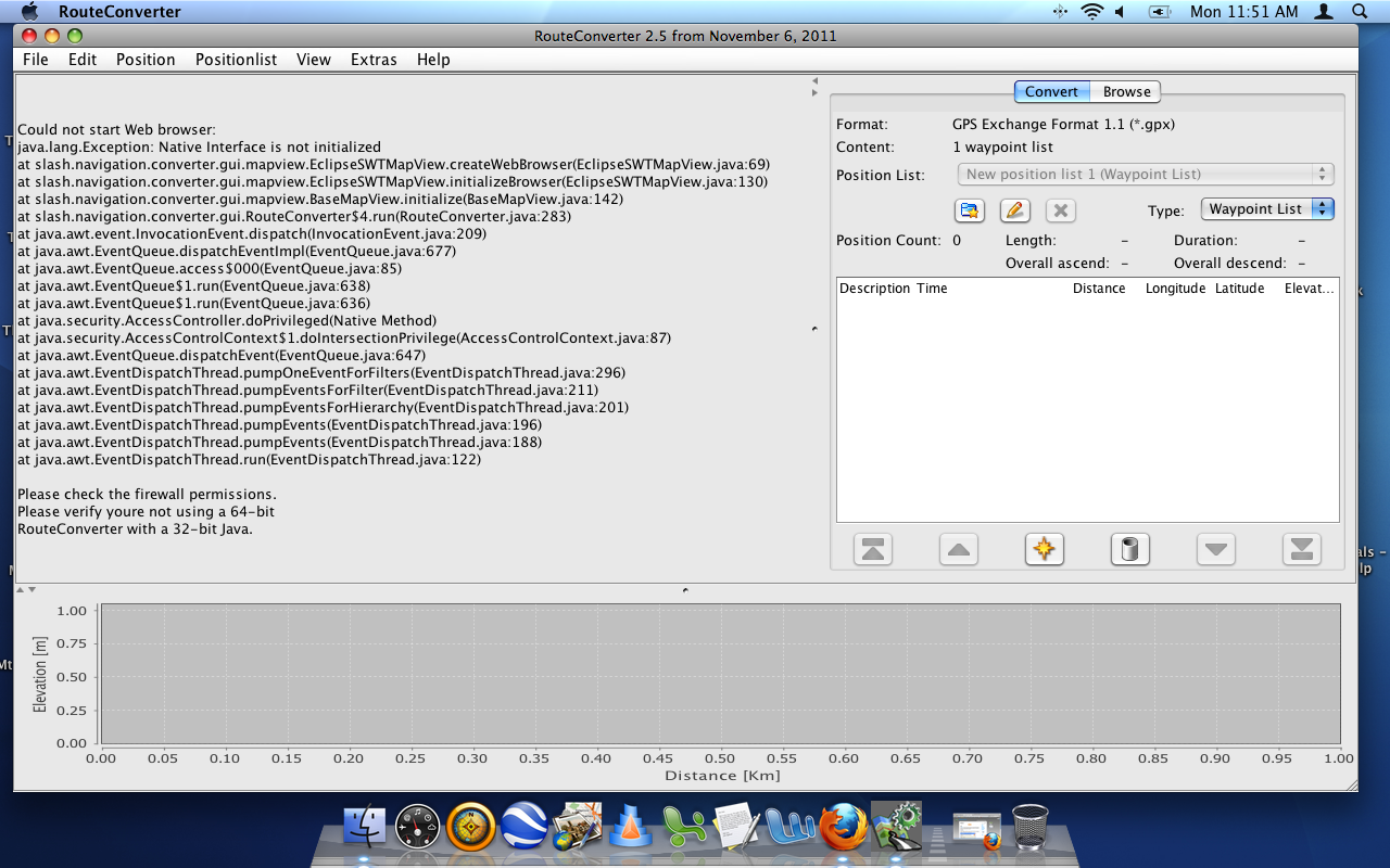

Java 1.6 is required by both the downladed version and the Web-based versions of RouteConverter, but MAC has not yet released an update to 1.6. How can I make this application work?
Note: In the case of the web-based vrsion, the application starts, but the right-hand side panel does not display the map. It displays "Could not start Web browser" instead

Christian,
The 64 bit version was the first option I tried, and still didn't work. Check out the error message in the attached pic.

Christian,
No luck. I did what you suggested but it still doesn't work. The error I get now is different, though. See the pic.
Also, the application now freezes completely and I have to do a "force quit". Any ideas?

(29.11.2011, 01:01)Palom0 Wrote: No luck. I did what you suggested but it still doesn't work. The error I get now is different, though. See the pic.
Yes, we need to find the bug. The screenshot shows a NullPointerException. I need the RouteConverter.log as described in the FAQ http://www.routeconverter.de/faq/errors/...og-file/en
