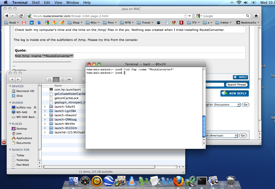

(30.11.2011, 17:00)routeconverter Wrote:
(29.11.2011, 17:45)Palom0 Wrote: Check both my computer's time and the time on the /tmp/ files in the pic. Nothing was created when I tried installing RouteConverter.
The log is inside one of the subfolders of /tmp. Please try this from the console:
Quote:find /tmp -iname "*RouteConverter*"
Nothing happens. See the pic
#13
