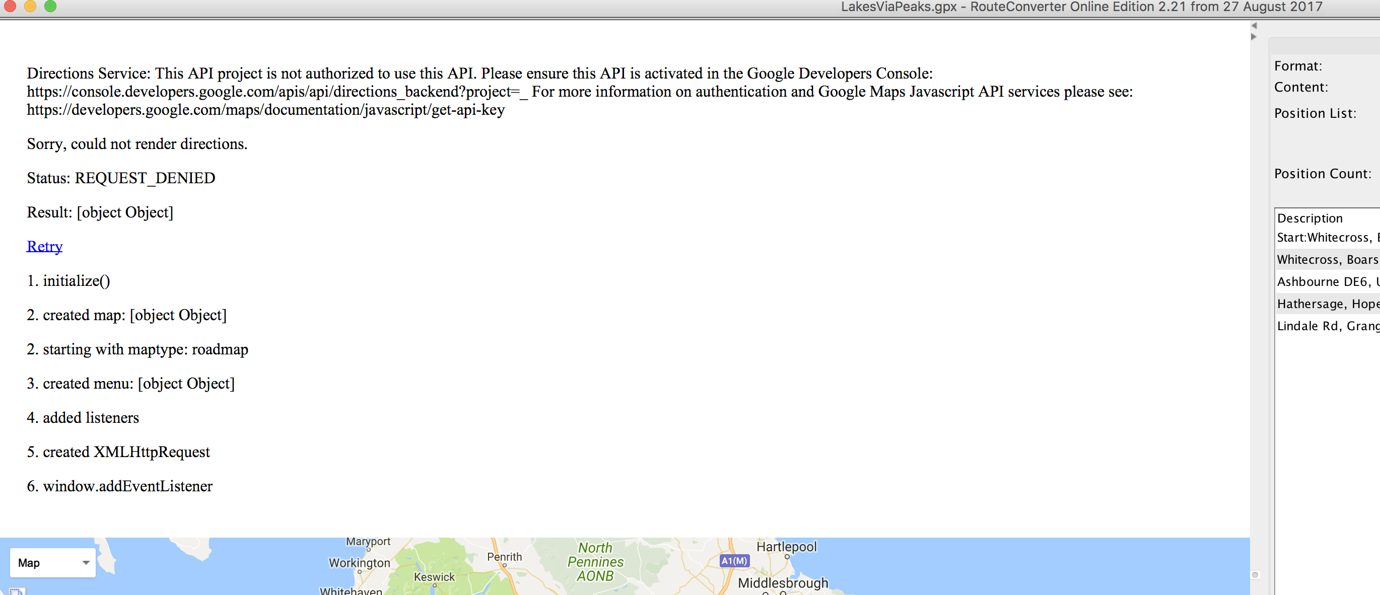

Since installing version 2.21, I've been getting a Google API Not Authorized message when attempting to display routes (see attachment).  I tried going back to my old version from 2013, and this shows the same error.

I'm also having the same problem running the Webstart version from my Win7 PC at work. Was working OK this morning for about half an hour, then the API error messages started showing when attempting to render a route.
Dear all,
for some reason the Google Directions API was deactivated. I've activated it again and it should now work again. Please report!
All working fine for me now - thanks a lot.
