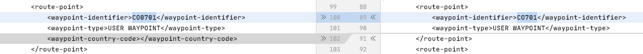

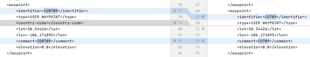

In the o (I suppose the older or origin) an additional element country-code is present which is missing in the newer file version. In this example in the comment the code is CO0710 (CO + 4 digits) thereas in the new one the leading zero is ommited (CO710)
route-point element in old one has a element waypoint-contry-code and the waypoint-identifier is also CO + 4 digits compared to the new version without leading zero CO + 3digits code (CO710)

I've had lots of interactions with a user that uses .fpl files and tried to improve them. The changes between your files are small:
The identifier is different and the country-code isn't written anymore. See the attached screenshots.
Please try the attached file c07now.fpl. Does it work for you?
