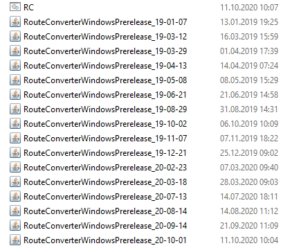

Addendum to above hint of @lundefugl
I like to have different versions of RC available on my PC to be able to make comparisons when I find a issue.
So I consequently rename the files immediately after download:
The uppermost file RC.bat has this content:
java -jar -Xmx2048m RouteConverterWindowsPrerelease_20-10-01.jar
Where -Xmx2048m gives RouteConverter 2GB of memory and _20-10-01 is the current prerelease version.
So I have to edit my batch file when I like to start a different version with 2GB memory assigned.
Nonetheless I can always start a *.jar with a a double click without memory assignment.
