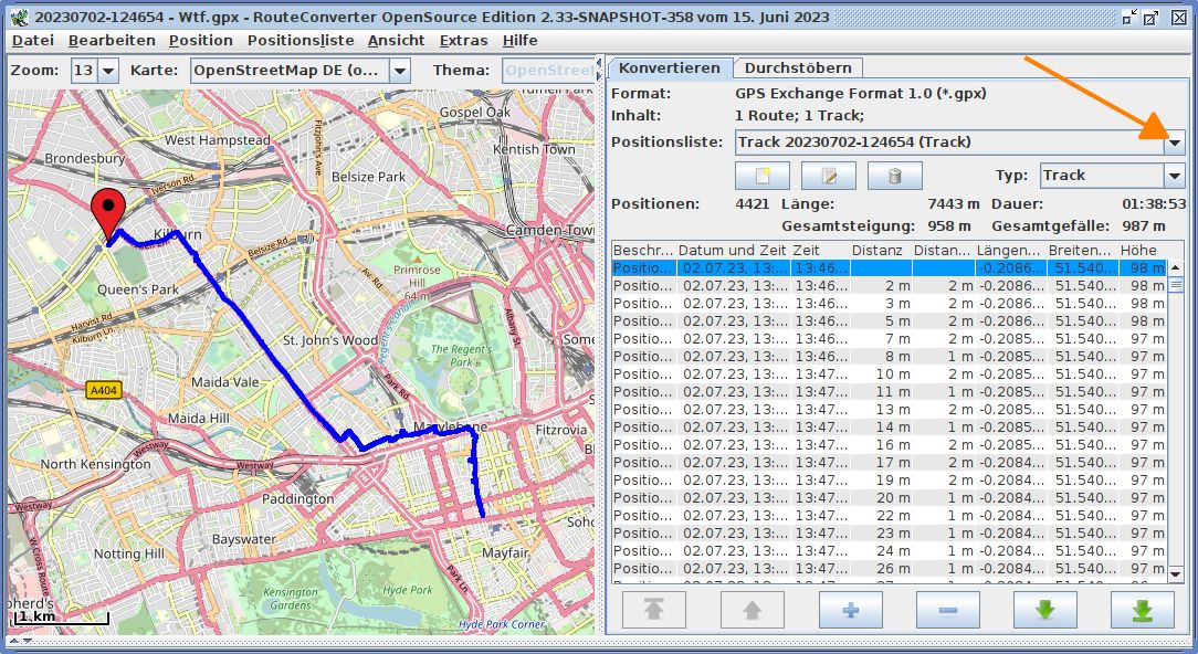

(02.07.2023, 18:24)grepnok Wrote: I've just downloaded and tried RouteConverter.  I like it that it's a single jar file with no external dependencies.  I created a test gpx file using GPS Logger on Android.  Opening this in RouteConverter, I get the four waypoints I created, but no trackpoints.  I don't necessarily need a list of every trackpoint, but I do want the route plotted on the map to show where I went.  It's just showing straight lines between each waypoint, and I can't find a setting that takes the actual route travelled into account.
@grepnok Click the pulldown triangle on the right of "Position List". RouteConverter uses different views for viewpoints and tracks. Unfortunately, the viewpoints are shown first.

What Wilfried said:
Quote:Unfortunately, the viewpoints are shown first.
No. RouteConverter just complies with the GPX Spec.
Thank you both.
I can now list all 4421 trackpoint positions.  And if I click on any of them I get a marker.  If I select all I get 4421 markers - not very pretty.

Unmark all trackpoints and RouteConverter will show you the trackline, you can set its colour and transparency in the Extras->Options menu. If you download and use the latest prerelease of RouteConverter you can also comfortably set the linewidth in the same menu.

I selected all because it was the only way I could get each trackpoint shown. If I selected none or one I only got the dotted blue straight lines between each waypoint.
If I go to Extras/Options/Colors and change the colours, on restarting I see the track line. I'll need the prerelease to make the line narrower.
