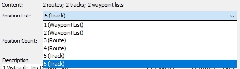

I created a *.gpx file containing six position lists:
Before saving: Two waypoint lists, two routes, two tracks
Then I stored everything as *.gpx file and re-loaded it again:

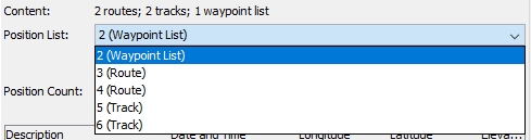

After re-loading: One waypoint list (that contains all waypoints of 1+2), two routes, two tracks
As per Wikipedia *.gpx files can contain all three types <wpt> and <rte> and <trk> several times.
BUT from the examples in Wikipedia I see that
    <metadata>         <name>name of the waypoint list</name>     </metadata>
can only applied once per *.gpx file.
It appears to me that all position lists of type 'Wapoint list' in a *.gpx file are handled together.
So (Christian may correct me) here we seem to face a limitation in the *.gpx file format.

(08.03.2020, 10:15)kumo Wrote: As per Wikipedia *.gpx files can contain all three types <wpt> and <rte> and <trk> several times.
That is correct.
(08.03.2020, 10:15)kumo Wrote: It appears to me that all position lists of type 'Wapoint list' in a *.gpx file are handled together.
That is correct.
(08.03.2020, 10:15)kumo Wrote: So (Christian may correct me) here we seem to face a limitation in the *.gpx file format.
That is correct. <wpt> doesn't have a structure that allows for multiple lists like <rte> and <trk> but it simply stored waypoints.
