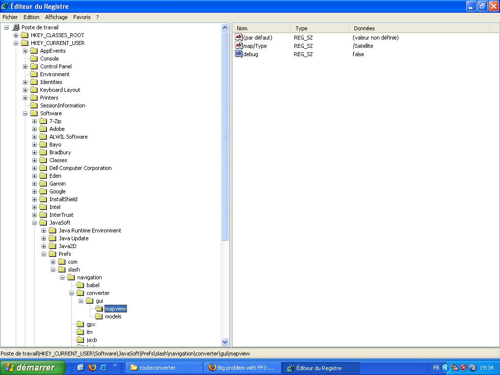

I am not at all familiar with the register editing. Regarding what you stated here under,
(26.07.2009, 17:45)routeconverter Wrote:
Quote:Windows Registry Editor Version 5.00
[HKEY_CURRENT_USER\Software\JavaSoft\Prefs\slash\navigation\converter\gui\mapview]
"debug"="false"
Have a look at the HKEY.JPG wich is attached. This is what I did. Not sure this is what should be done. Tell me whether this OK or not. In case it is "not", would you please give me detailed information.
Best regards.
Bernard
#12
(26.07.2009, 20:46)aristide Wrote: Have a look at the HKEY.JPG wich is attached. This is what I did. Not sure this is what should be done. Tell me whether this OK or not. In case it is "not", would you please give me detailed information.
Hi Bernard,
everything is fine - except that I was wrong with "false". Please set it to "true" to for more debug output in the log and on the console.
