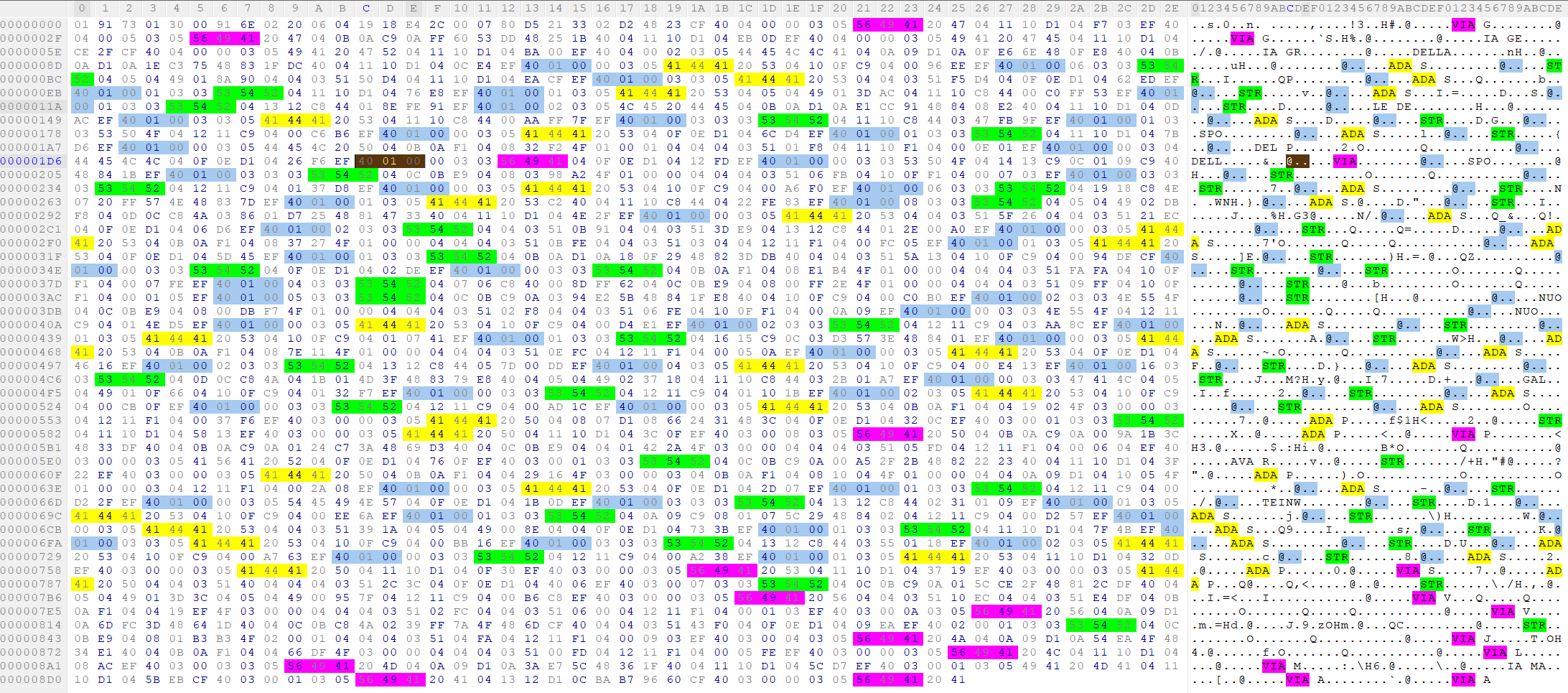

Das kann natürlich gut sein, quasi die Instruktionen für "Agora" als serialisierter CString.
Ich habe leider keine einfache Möglichkeit gefunden einen CString schnell mal zu deserialisieren, ohne dafür direkt ein eigenes Programm schreiben zu müssen. Mit CString ist wahrscheinlich das hier gemeint: https://docs.microsoft.com/en-us/cpp/atl...ew=vs-2019
Da zumindest das NBT Evo ohne diesen AgoraCString auskommt, habe ich erstmal nicht vor viel Arbeit da rein zu stecken. Wer Zeit und Lust hat, kann aber gerne versuchen das Geheimnis zu lüften, ich habe dazu einmal die Base64 enkodierte Version von 2 AgoraCStrings angehangen, sowie die daraus entstehenden Binaries. Smile
In den Binaries gibt es auf jeden Fall Muster:
.zip   AgoraCStrings.zip (Size: 4.02 KB / Downloads: 641)

I hope I can contribute to the discussion, AgoraCString, I think is referring to the Agora-C geoposition standard defined in ISO 17572-3 for Dynamic location references. Unfortunately it is used in Nav of BMW 5series G30 NBT Evo S19322I. Without that field, the route is not interpreted fine in the Nav system. Unfortunately I have not access to this standard to see compression method and xml format, just to try to decode, understand and encode the right AgoraCString to be added to Navigation file.

Having said that, I have reviewed the doc and, honestly is too much for me, I have no skills to "decode" de binary implementation, and beyond of that I cannot see how to "match" the binary options with the special codification of AgoraCString (from some examples I got from the BMW web when it was up and running), it only uses characters from a subset (A-Z a-z 0-9 / + =). I am going to convert the first latitude (float64) included in the route to binary, and try to find the sequence of bits in the AgoraCString, just to find a "reference", but I am not convinced I am going to succeed, too much uncertainties. I'll keep you informed if I make any progress.

Dear Colleagues, finally I have decoded the AgoraCString...
First step, I have realized that the stored string is coded in base64, and it is a lot of literature about that, in fact in Golang there is a specific library "encoding/base64" that code/decode this "strings". With that I was able to get a coherent bit stream to work over it.
From that, the standard used is the above mentioned AgoraC, binary model, it is really complex and the examples I have (old routes generated with bmwroutes.com) shows that they are really coding absolute and relative coordinates, type of roads, roundabouts,... these information is not set in a gpx file, so I'll try to simplify a little bit, and if it works I'll share with you the result.
